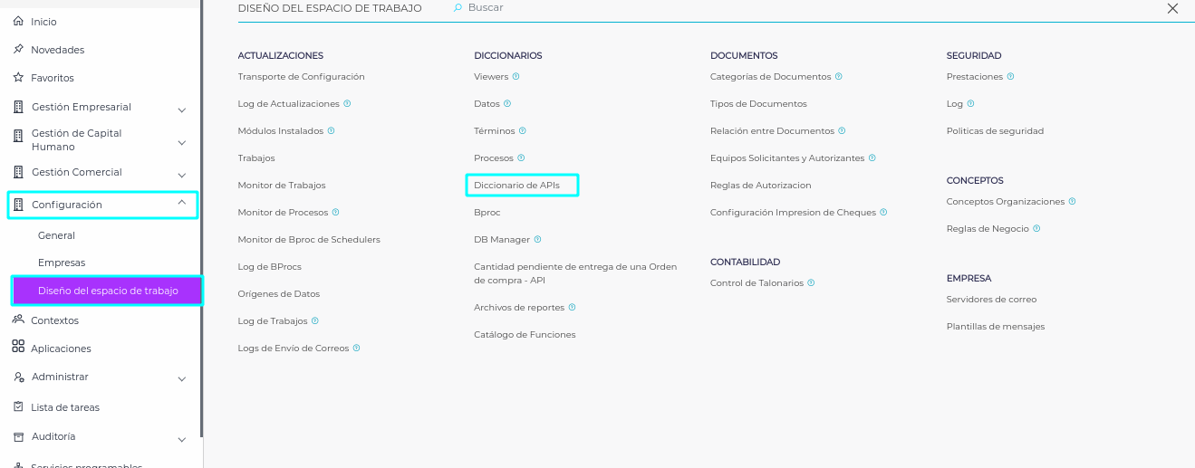

  1. Log in to Finnegans, then go to Menu > Configuración > Diseño de Espacio de Trabajo > Diccionario de APIs.

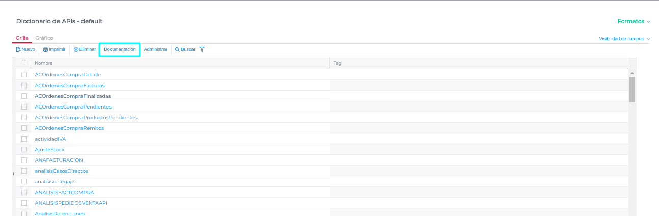

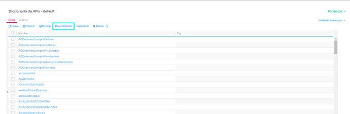

  1. Next, once on the Diccionario de API viewer click on the “Documentación” button and you’ll be redirected to documentation with the different URLs that Finnegans provides for each API.
It’s important to remember that each API displays information segregated by method.
